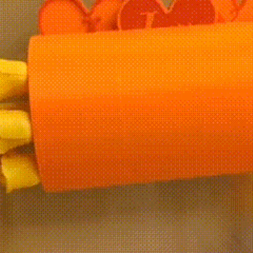

你需要:
• 3m胶足量
• 磁铁至少16颗,建议10mm,如果觉得磁力不够,也可以换成13颗12mm磁铁和3颗10mm磁铁
钥匙和锁要加支撑
安装如下:
• 1、如图,安装磁铁,绿圈最大放入12mm磁铁,红圈最大放入10mm磁铁
磁极如下,绿圈红圈的磁极相反
Want to surprise your mother? I believe this model is a good choice
You need to:
• Sufficient amount of 3M glue
• At least 16 magnets, 10mm is recommended, if you feel that the magnetic force is not enough, you can also replace it with 13 12mm magnets and 3 10mm magnets
Keys and locks should be supported
The installation is as follows:
• 1. As shown in the figure, install the magnet, the green circle is up to 12mm magnet, and the red circle is up to 10mm magnet
The magnetic poles are as follows, and the magnetic poles of the green circle and the red circle are opposite
另:如果转的费力,可以在钥匙上的两个空孔装磁铁,并在锁暂停时放入磁铁,保证相吸
• 2、在锁的3个孔从左(有玫瑰处)依次放入I,love,you,使其正面朝外
In addition: if the rotation is laborious, you can install magnets in the two empty holes on the key, and put the magnets when the lock is suspended to ensure that they attract each other
• 2. Put I, love, and you in the 3 holes of the lock from the left (where there are roses) in turn, so that the front side is facing outward
最右边放入玫瑰并旋转180度,移至内部;
Put the rose on the far right and rotate it 180 degrees to move inside;
将my放入卡槽,在调节孔放入小磁铁进行尝试吸附
• 3、my卡入卡槽后,将锁贴到墙上,将遮挡装在底板mum上并安装固定件(可用502粘上),拉出my,使其与遮挡细的一端头部接触,遮挡与底座mum成30度角左右,贴上底座
Put my into the card slot and put a small magnet in the adjustment hole to try to adsorb
• 3. After MY is snapped into the card slot, paste the lock to the wall, install the shield on the bottom plate mum and install the fixing parts (502 can be used to glue it), pull out the MY, make it contact with the head of the thin end of the shield, and the shield is about 30 degrees angle with the base MUM, and paste the base
• 3、插入钥匙,逆时针旋转90度,如果旋转前my落下翘起遮挡,露出my,旋转后I,love,you跳出即为成功(封面图效果),如果不可以或旋转很费力,可以相应调节更小或更大的磁铁,如果无法插入或旋转,可以砂纸打磨
装好后你就可以将其回归初始,把钥匙送给母亲,让她打开这把锁吧
我提供了一版配色,也可以以粉色为主题
锁的表面我没有雕刻纹饰,你可以自由设计
欢迎二创,禁止商用
• 3. Insert the key, rotate 90 degrees counterclockwise, if my falls down before rotation and covers it, revealing my, after rotation I, love, you jump out is successful (cover picture effect), if you can't or rotate very laborious, you can adjust the smaller or larger magnet accordingly, if you can't insert or rotate, you can sandpaper sanding
Once you've installed it, you can return it to its original and give it to your mother so that she can open the lock
I've provided a color palette that can also be themed pink
I don't have carved patterns on the surface of the lock, so you can design it freely
Welcome to the second creation, prohibit commercial use
