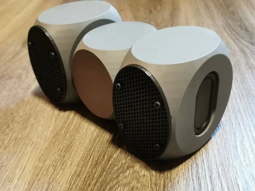

20W Stereo Bt speaker
Parts: -DC 5V TWS BT Amplifier Module 10W+10W Dual Channel Digital Stereo :
Bass Passive Circle And Ellipse Diaphragm Low-frequency Radiator Subwoofer (40x70mm racetrack) : https://www.aliexpress.com/item/1005007657193412.html?pdp_npi=4%40dis%21HUF%21HUF%20806.68%21HUF%20556.70%21%21%2116.78%2111.58%21%40211b87e117717426199222953ded7c%2112000041734996854%21sh%21HU%21723485383%21X&spm=a2g0o.store_pc_home.allitems_choice_2010158625325.1005007657193412
2Pcs 2 Inch Portable Full Range Speaker 53MM 4 ohm 10W :
-2pcs 18650 li-ion cell 2000-2500mah ( need 8A continous discharge) Connect the cells in parallel, ( 3,7v, 4000-5000mah )
-M3 nuts and bolts (
-M2 bolt for the bottom cover
-rubber glue
