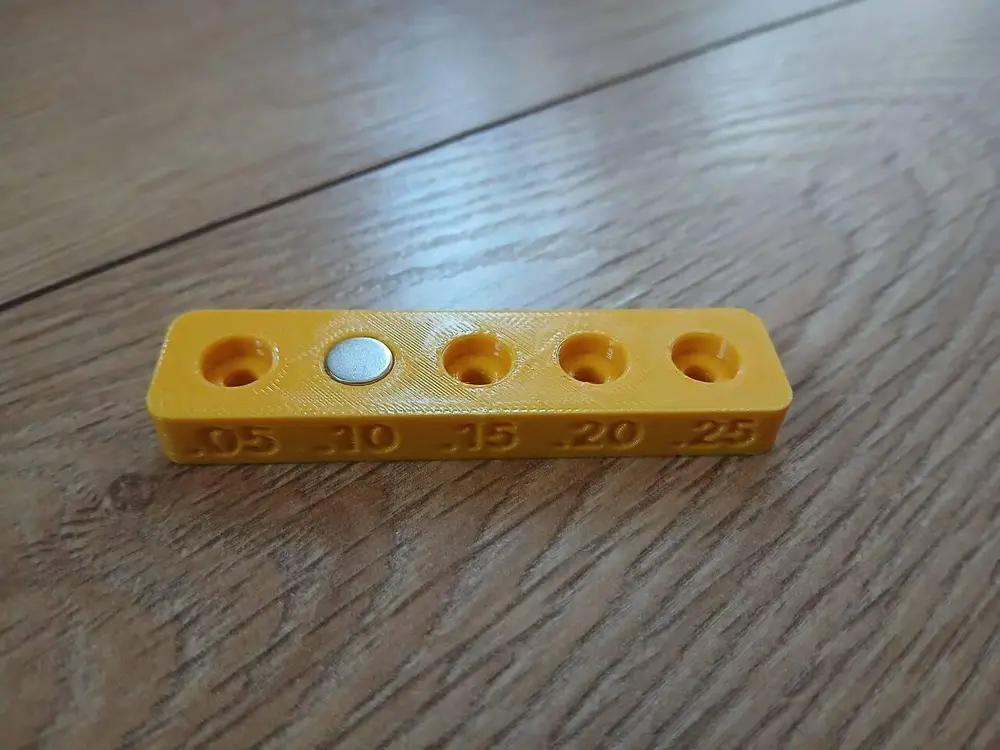

Simple test for FDM/FFF 3D printer that shows which tolerance is the best for 8x3 magnets. Try to insert the magnet into each hole. In your design, use the tolerance indicated under the hole that provides the best fit. To remove the magnet, push it from below with a stick.
