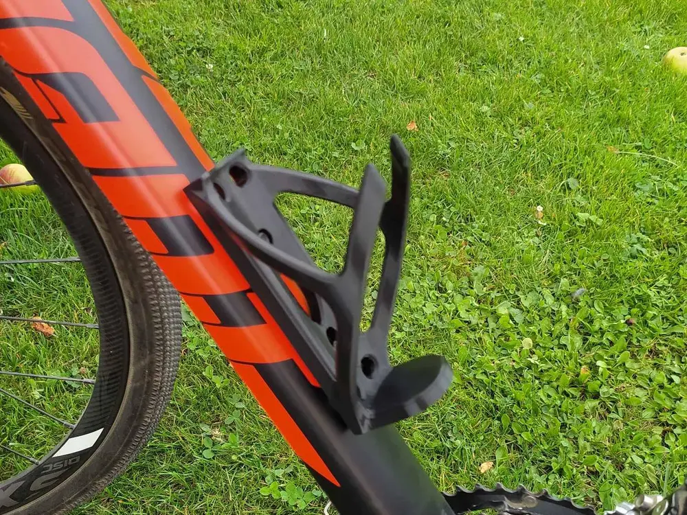

Ever found yourself without a water bottle holder for your bike? That's exactly what happened to me, so I decided to create my own. Here’s the design I came up with, and I’m currently using it on my bicycle. It’s specifically designed to fit standard cycling bottles.
Printing Details:
- Infill: I printed mine with 25% infill. Lower infill values resulted in the arms printing nearly hollow, which I wanted to avoid.
- Material: PETG filament.
- Supports: No supports are required. Just print it and mount it.
- Design Feature: The counterbores are designed so that the bottle cage screws will sit flush with the top surface of the cage, ensuring they don’t touch your bottle.
