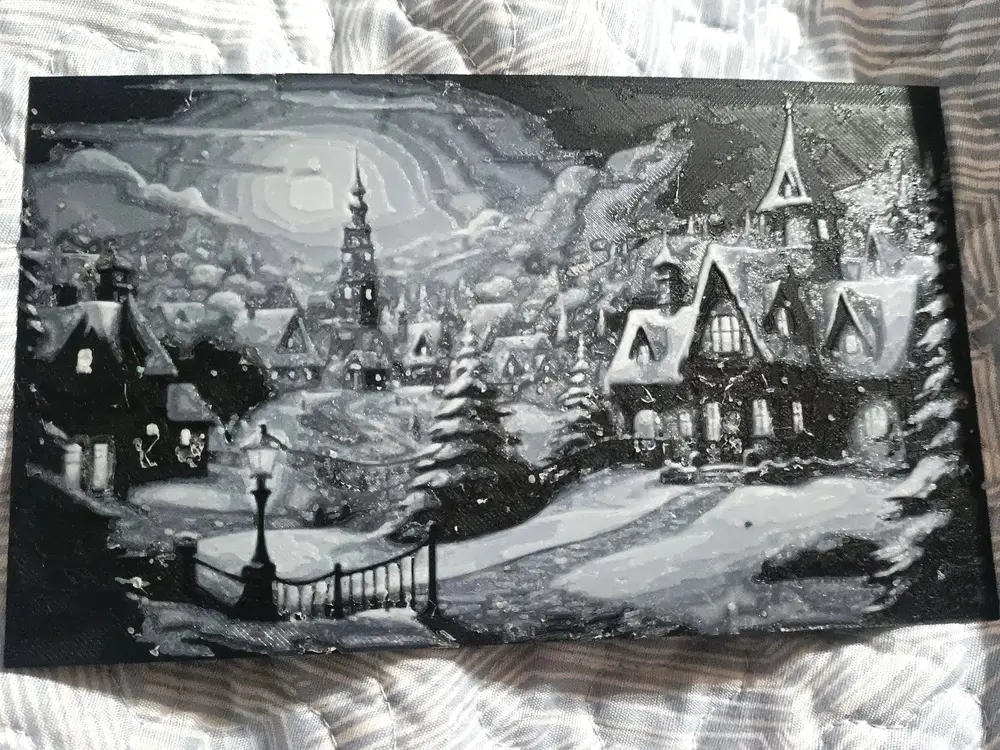

Print with 100% infill and a layer height of 0.08 mm, with a base layer of 0.16 mm.
The model measures 200 x 119 mm for the standard version.
It is possible to print with higher layer heights below the minimum depth of 0.24 mm.
The maximum depth is 2 mm, and the effective depth is 1.2 mm.
Filaments used:
-esun PLA Black
-SUNLU PETG White (I only had PETG, for better layer adhesion I suggest using PLA)
Switching instructions:
-Start with Black.
-At layer #5 (0.48 mm), switch to White for the remainder.
Original Model by Haledesigns3d
