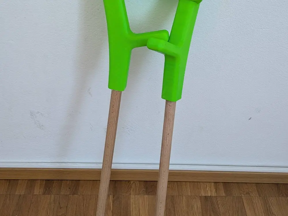

My kids like to play all sorts of things. One of them is beeing medical staff and treating others. So of course every once in a while somebody has a broken leg which needs a cast or something and then they also need crutches.
I printed them in PETG, but PLA should also work fine.
The feet are designed to be printed with TPU.

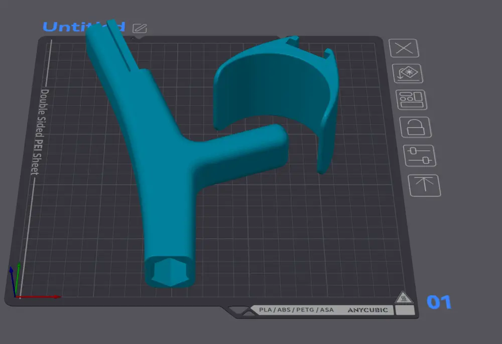

Make sure you print the hand-touching handle on its side so the forces will be perpendicular to the layer lines.
The hand part is designed so you can insert a 20mm diameter stick in the desired length.
