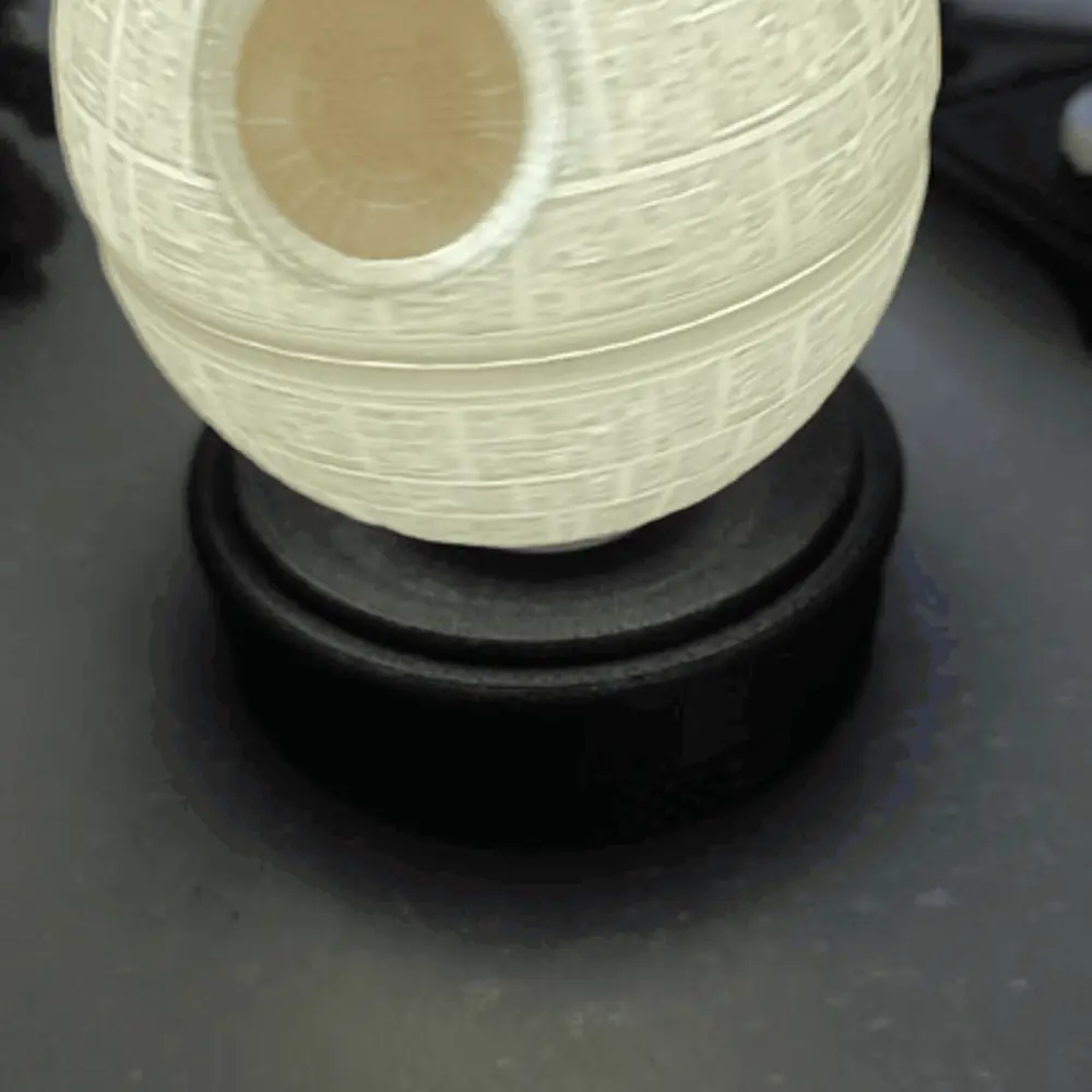

For easy put the Death Star on the maglev, put it first on a flat surface so you can find the center of gravity. Lift it with both hands and put on the maglev.
Instructions:
Start by putting the light/magnet inside the south part of the Death Star. No need to dismantle as it will fit.
Use the lock part to keep it in place. It should be tight if not, depending on your filament, you can always adjust. Take 5 minutes to print.
Finish with the north side of the Death Star. Should just click in.
Remove magnet kit from the original housing and disconnect power wire.
Insert power wire through the base hole and use nut to secure it. The nut will go inside the base. Make sure wires are horizontal like in the picture.
Connect magnets and insert into base as shown in picture. Make sure wires are underneath and not under supports.
Insert light switch into the slot with wires sliding down
Finally insert lid. You can use glue to keep it in place. I like to use soft glue (T-8000) in case i need to later open it.
