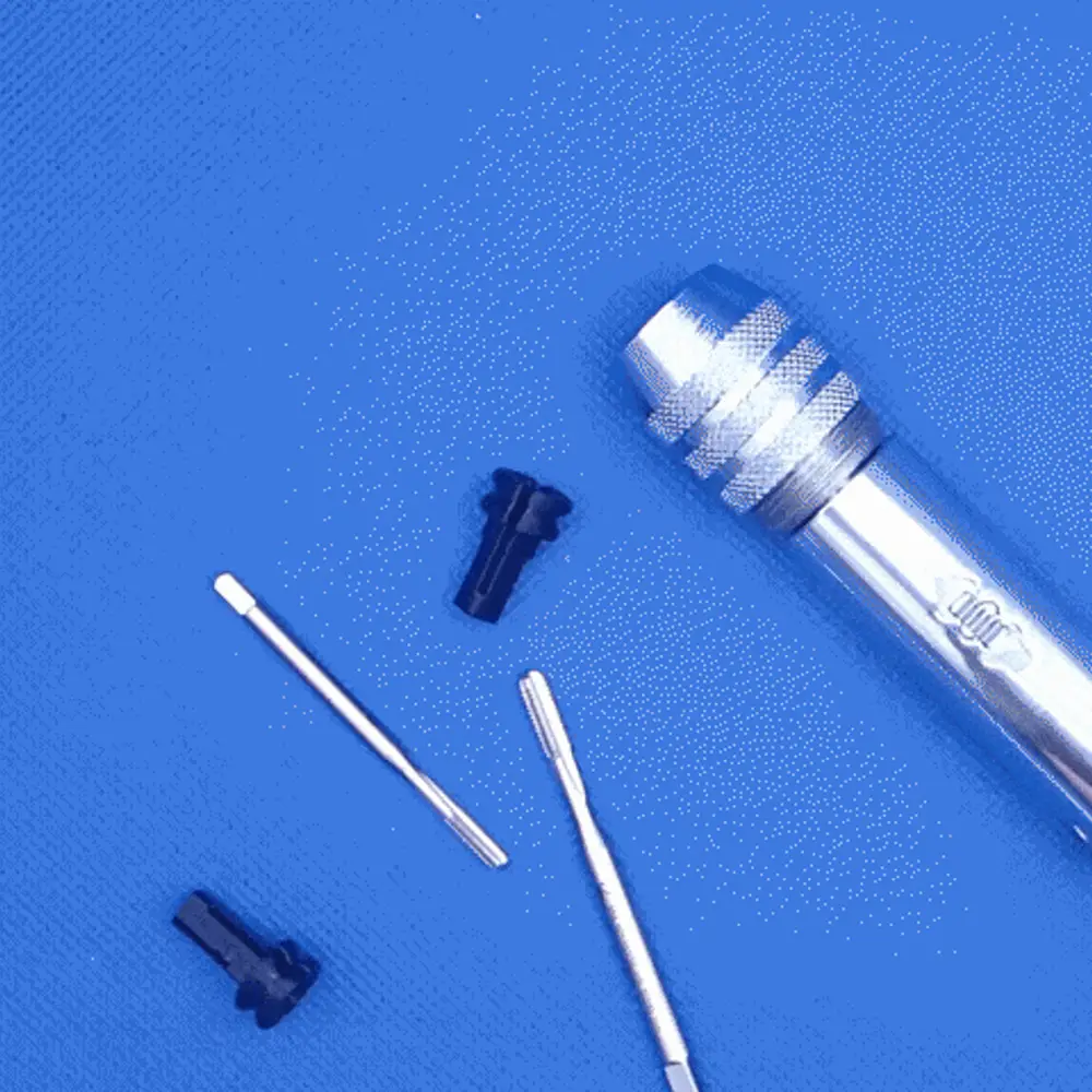

 Ever needed to tap a thread but couldn't find a small enough tap wrench? This simple emergency adapter solves that problem. Designed to hold M3 and M4 tap heads and fit any wrench that accepts a minimum 6mm square drive, these adapters turn your standard tools into precision threading tools.
The Story:
I had a full set of taps but nothing small enough to hold them properly. Rather than buying specialized tools, I designed these adapters in minutes and printed them immediately. They worked perfectly for light threading jobs—calibrating threads in metal or cutting threads in plastic.
What It Does:
  • Converts standard tap heads to fit larger wrenches
  • Holds M3 and M4 taps securely
  • Fits any tool accepting a 6mm minimal square drive
⚠️ IMPORTANT LIMITATIONS ⚠️
For Light Use Only:
These adapters are designed for very low torque applications:
  • ✅ Calibrating existing threads in metal
  • ✅ Cutting threads in plastic
  • ❌ NOT for cutting new threads in hard metals
  • ❌ NOT for high-torque applications
The plastic construction simply isn't strong enough for serious metal threading. For heavy work, invest in proper metal tap wrenches.
Print Settings:
  • Material: PETG recommended for better layer adhesion. ABS/ASA works. PLA is acceptable
  • Supports: No
  • Brim: Not necessary
Need a Different Size?
Do you need an adapter for other tap sizes or a different drive dimension? Message me with your requirements, and I'll create a custom version!
