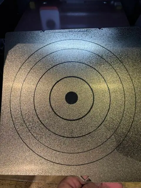

Improve your 3D printer's first layer with the First Layer Test – Circle!
This simple calibration model uses circular patterns to help you evaluate first-layer adhesion, extrusion consistency, and Z-offset settings.
Unlike traditional square calibration tests, circular shapes allow you to inspect how consistently your printer lays down filament along curved paths.

How to Read the Results
Perfect First Layer: Smooth, consistent circular patterns with well-connected extrusion lines.
Gaps Between Lines: May indicate insufficient first-layer squish or under-extrusion.
Rough or Raised Surfaces: May indicate excessive first-layer squish or over-extrusion.
Poor Adhesion Around Curves: Check bed cleanliness, Z-offset, temperature, and first-layer speed.
Inconsistent Circular Patterns: May indicate uneven extrusion or motion-related issues.
