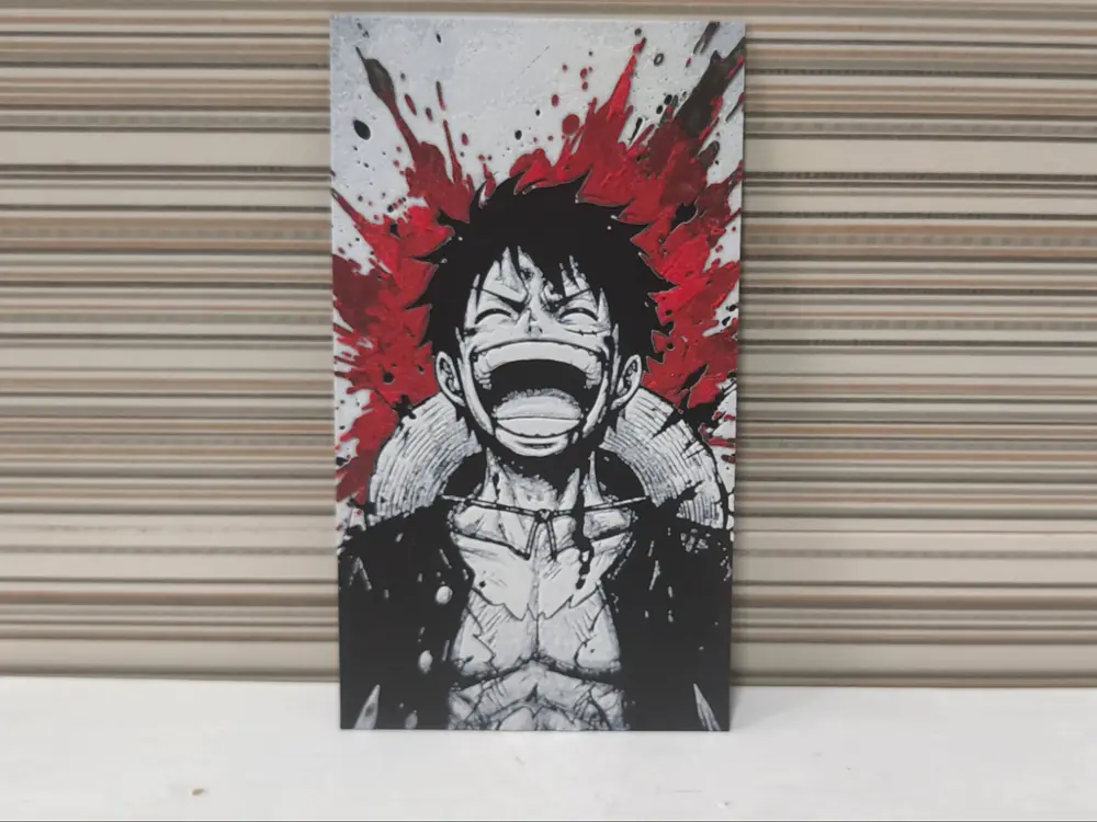

Hueforge Luffy One Piece
@Mejoren3d_2379220
Print at 100% infill with a layer height of 0.08mm with a base layer of 0.1mm
Swap Instructions:
Start with Black
At layer #7 (0.58mm) swap to Jade White
At layer #14 (1.14mm) swap to Black
At layer #15 (1.22mm) swap to Red for the rest.
