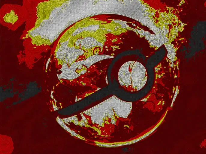

Print at 100% infill with a layer height of 0.08mm with a base layer of 0.16mm
Swap Instructions:
Start with Black
At layer #6 (0.56mm) swap to Brown
At layer #11 (0.96mm) swap to Red
At layer #16 (1.36mm) swap to Yellow
At layer #21 (1.76mm) swap to White for the rest.
