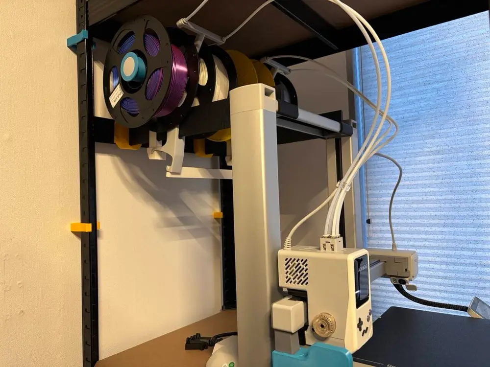

This model allows you to move the Kobra X in a system shelf as it moves the spool holders a bit lower and further to the back.
  • In the back the braces are hold with a clip (yellow part in the picture) that slides into the metal support that comes with the Relaxdays shelf, so if you have a different brand, some adjustment might be required.
  • There's a left and a right model as the spacing between the two holders is quite specific
  • The spools mount to the original Kobra X holders that you slide onto the braces.
  • The small clips go over the brace and clamp on to the spool mount, ensuring it stays in place.
  • There's a spacer that clicks into the bottom of the spool mounts which prevents the spools from tilting if one side is heavier than the other
  • The buildplate with the shelf center support and corner covers is optional if you happen to have the same brand shelf. It provides a more flat bottom so the printer sits stable.
