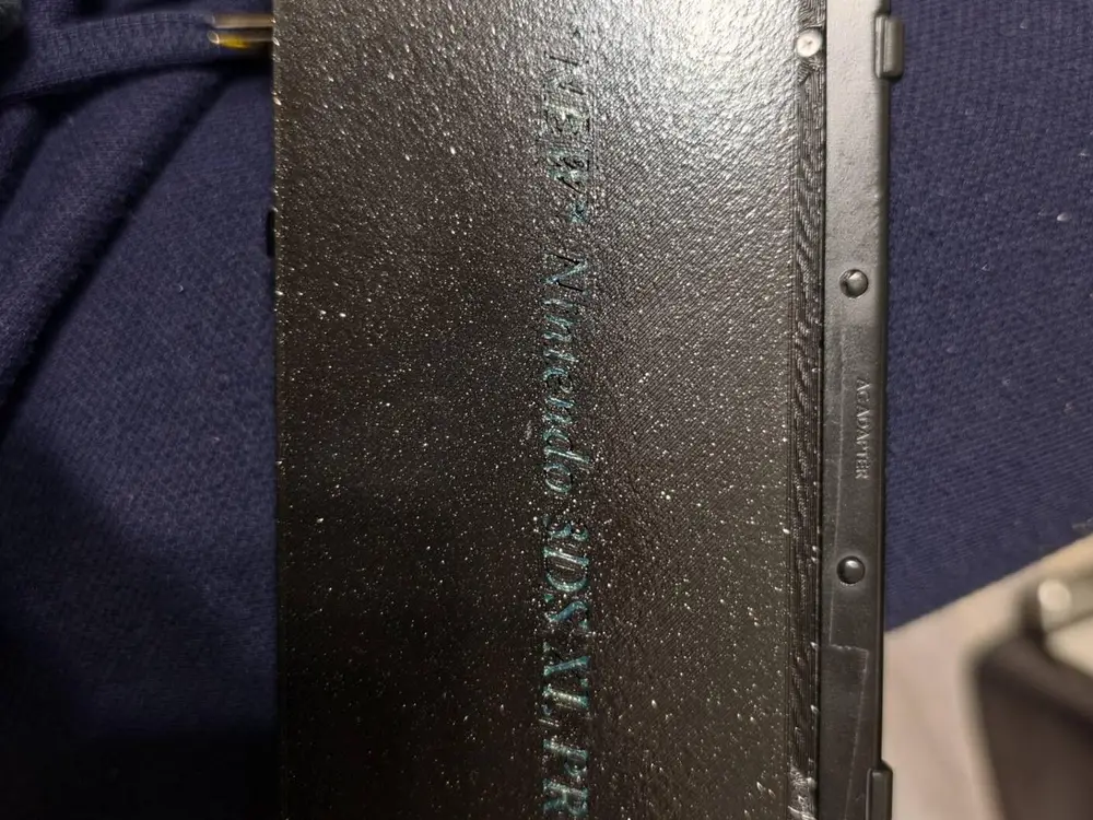

I was so tired of not seeing any back plates for the New 3DS XL if you wanted to use the Extended Battery (Cameron Sino battery, it's on Amazon) so I made one. I went and downloaded a back plate that was made by gmoff01 on thingiverse, and kept putting it and some structures together, going through a total of 10 iterations, before it worked. Now this backplate does leave around 4mm of space between the battery and the plate, so I recommend using something to fill it (I used a 2mm thermal pad, cut it into 2, and stacked them on one another). I also included on a separate plate a spacer, made by Wurmatron on printables, as to connect the extended battery to the port. If you want to change this or improve the design, you're welcome to!
Update: I have revised this backplate so that you can use some free space to carry up to 3 ds/3ds cartridges with you
