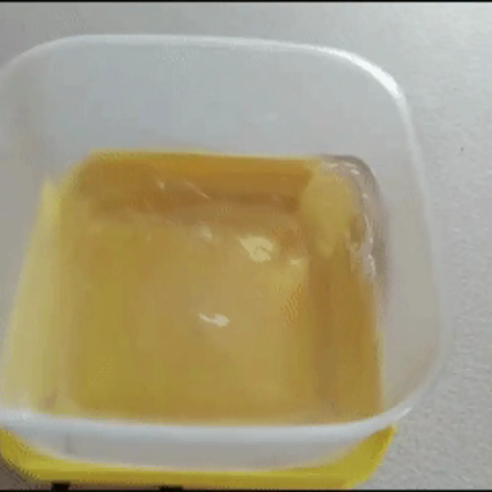

Orbital shaker: A shaker with circular motion on a horizontal plane. Therefore, this type is ideal for cell cultures, microbiological research, and solubility studies. Furthermore, the constant motion ensures uniform mixing of liquids in Erlenmeyer flasks and culture bottles.
You will need the following parts:
- Power bank or 5V cell phone charger.
- TT motor with a 200 rpm dual-shaft gearmotor
- PWM speed controller
- 4 M2 screws with their corresponding nuts
- female USB-C panel connector
You can see it in action here.
