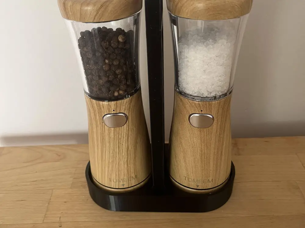

It is designed to hold Salt and Pepper grinders. It keeps all the accidental button presses contained while being easy to move from a shelf to the dining room table for meals.

I would use PETG for this print for strength instead of PLA. If you have good PETG settings it shouldn't be too hard but if not it will warp. I used 5 walls for extra strength but depending on how heavy your salt and pepper grinders are you might not need as many but I wouldn't drop it below 3 walls. Make sure that it is dried properly because on the tall section there could be a lot of stringing. If you have any problems please leave them in the comments.
