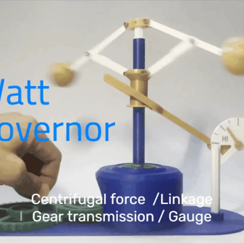

Watt Governor Model for Demonstrating Centrifugal Force and Gear-Rod Transmission
The original device was used to regulate steam input and is a milestone in mechanical automatic control;
In the model, steam input control is replaced with a “dial” to visually show the size of the centrifugal force.
Assembled dimensions are approximately 260*90*180mm.
瓦特速度调节器模型 用于展示离心力和齿轮、连杆传动
原装置为调节蒸汽进入量,是机械自动控制的里程碑;
模型将蒸汽进入控制,改为了“表盘”,以直观展示离心力的大小
组装后尺寸约 260*90*180mm
  • Simulates a double-ball centrifugal governor to demonstrate centrifugal force.
  • Input via high-ratio gear transmission
  • Linkage pushes the “centrifugal force gauge” for a visual display
  • The two balls in the print are filled at 75% to increase weight
  • Bushing design: Shaft printed horizontally, bushing printed vertically to ensure strength and improve smoothness, no extra lubrication needed
  • Bushings and sliders use random seams
Chassis, bushings, and support seats use PLA.  Others use PETG.
A few supports and the pointer might need glue, and the main shaft might need some sanding.
  • 模拟双球离心调速器,演示离心力
  • 齿轮大比例传动输入
  • 连杆推动“离心力表”直观展示
  • 打印配置中双球使用75%填充增加重量
  • 轴套设计,轴横向打印,轴套纵向打印,保证强度同时提升光滑度,无需额外润滑
  • 轴套、滑块使用随机接缝
