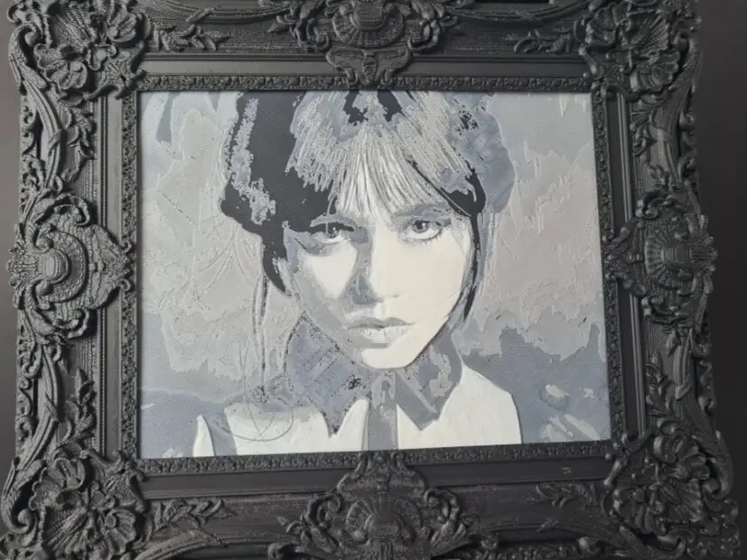

A picture taken of the famous serie Wednesday on Netflix, putted on black and white, and edited in hueforge.
Cool baroque frame modeled to perfectly fit it.
for the picture:
Print at 100% infill with a layer height of 0.08mm with a base layer of 0.16mm
Filaments Used:
PETG JAYO Black Transmission Distance: 0.3
PETG JAYO Gray Transmission Distance: 2.5
PLA creality grey Transmission Distance: 6
PETG JAYO White Transmission Distance: 6
!!!! It appears you have mixed filament types. Be certain this is what you want. !!!!!
Swap Instructions:
Start with Black
At layer #7 (0.64mm) swap to Gray
At layer #10 (0.88mm) swap to grey
At layer #12 (1.04mm) swap to White for the rest.
for the frame, it's full in mate black
