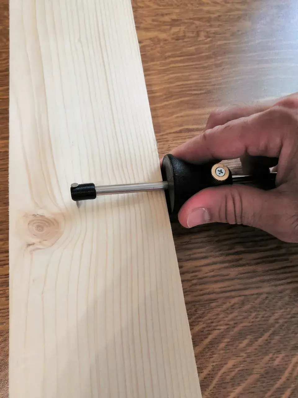

Carpenter's gauge. Required: 6mm metal bar, m4 nut and screw, an old filament drive gear to use as a knob. A 2mm nail to use as a marker.
