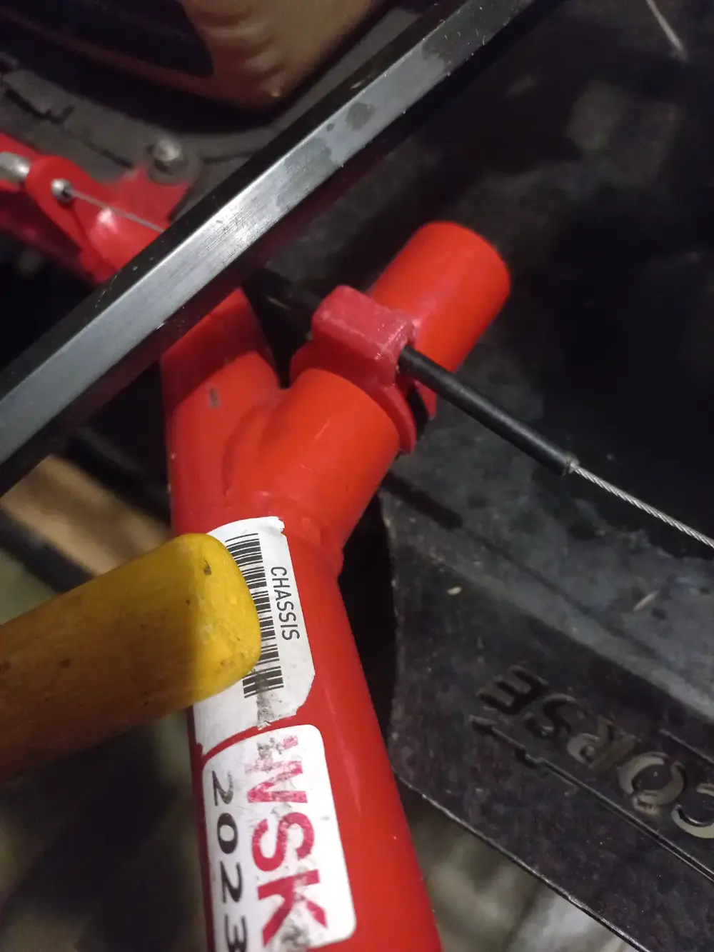

gokart throttle cable sheat support
@wildshark_1426152
This accessory is engeenered to keep throttle cable low. Not all chassis brand allow this type of installation.
Put a piece of biadesive tape between chassis and grommet to prevent rotation.
