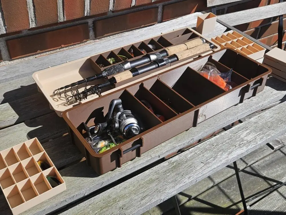

This tackle box will carry 2 short telescopic rods one small reel and a good deal of accessories
print the parts and assemble them, use split to parts to fit on print bed, they will be a tight fit.
glue the half's together and pin the lid in place, i use superglue.
the printed pins will work, but a 5mm steel or fiberglass rod is better, I glued my pins in place for safety.
A full print of this model takes ca. 450g of pla filament.
