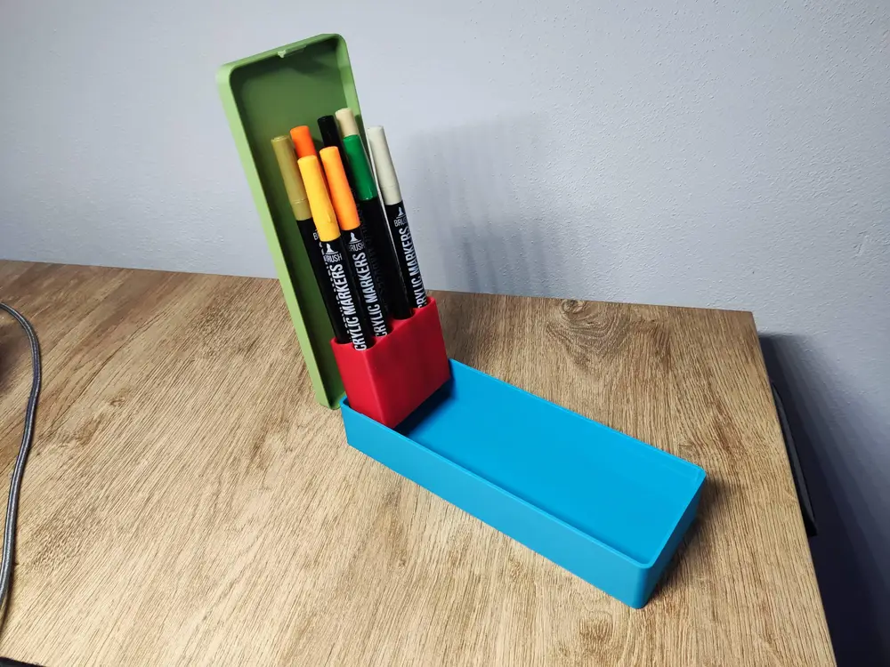

A Pencil Box that lifts your pencils when opening.
I printed it without any supports.
For the briges i printed with 10mm/s.
Assembly:
- To assemble the hinge just stick a piece of filament into it. (If the piece of filament is loose and would fall out, you can melt the ends a bit with a lighter or a soldering iron.)
- The magazine snaps into the housing.
- The little pull rod snaps in at the lid and the magazine.
Have fun printing and leave a like if you like ;-)
